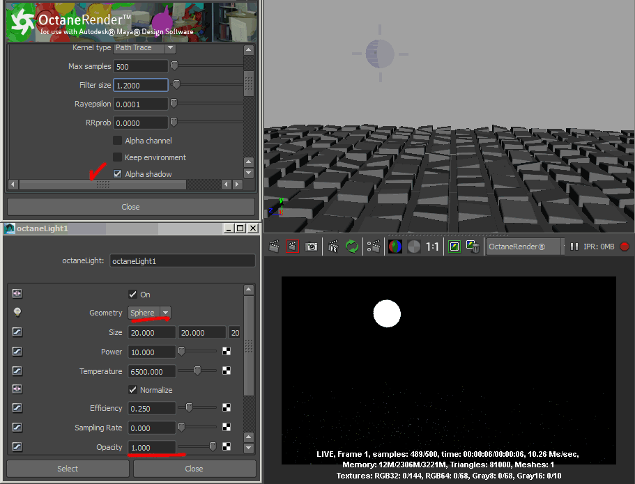

IPR is working normally with a couple previously made scenes I tested so far. Planar lights are also fine.
The sphere light has this strange behavior occluding it's own light, being subject to opacity and alpha shadows. If alpha shadows is off, it doesn't light anything except itself (and a few fireflies from occasional indirect light).
With opacity set to 0 and alpha shadows on, it works fine.
It also seems to have some interference if I add a mesh with emissive material in the scene:
GTX 1080 8gb, GTX 970 4gb, I5 4590, Z97-E, 32gb RAM, Win 10 64bits, Octane for Maya

ivankio wrote:IPR is working normally with a couple previously made scenes I tested so far. Planar lights are also fine.
thanks for that transparency tip, when I adjusted my Octane lights, they started working.
