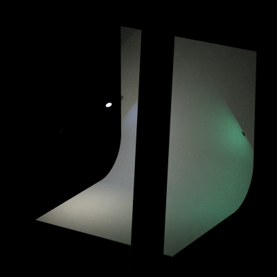

Well, alas, the normals are perfectly fine. So it's something else.
Here it is with Daylight, and no custom lights:

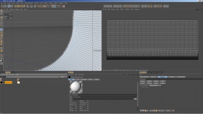

treddie, why is this bg not a plane?.. why is there thickness? I have done bg ramps as a plane with one UV and never had anything but smooth-as-butter renders...
That is because this studio was built eons ago for another renderer. As I recall, I was having issues with simple one-sided surfaces. So the polys are unnecessarily high now, but it should still work.
Do you indeed have a UV in this bad-boy?
Only a standard flat projection from C4D, which is only holding a flat white bg (no texture, per say). In Octane, I am not applying any bitmap texture to it.

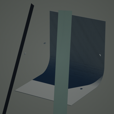

Ray Epsilon was it ! WOO-WHOO!
I had to kick it way up to .06. Also sped the render up a zillion-fold:
