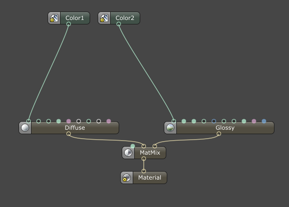

Here's the small example that will create this simple shader setup inside a custom node graph (ie. "macro"):
Code: Select all
-- table with params for the "macro" node graph
params = {}
params.type = octane.GT_STANDARD
params.name = "Proto Shader"
params.position = {200, 200}
-- creates the "macro" node graph, ie. root for all other nodes
root = octane.nodegraph.create(params)
-- creates two texture input pins and populates them with RGB texture nodes
inColor1 = octane.node.create{type=octane.NT_IN_TEXTURE, name="Color1", graphOwner=root, position={300, 30}}
inColor2 = octane.node.create{type=octane.NT_IN_TEXTURE, name="Color2", graphOwner=root, position={400, 30}}
inColor1Node = octane.node.create{type=octane.NT_TEX_RGB, pinOwnerNode=inColor1, pinOwnerId=octane.P_INPUT}
inColor2Node = octane.node.create{type=octane.NT_TEX_RGB, pinOwnerNode=inColor2, pinOwnerId=octane.P_INPUT}
-- change the color attribute for the RGB texture nodes to not 100% bright red & yellow
inColor1Node:setAttribute(octane.A_VALUE, {0.75, 0, 0})
inColor2Node:setAttribute(octane.A_VALUE, {0.75, 0.75, 0})
-- creates the output pin, material type
outMat = octane.node.create{type=octane.NT_OUT_MATERIAL, name="Material", graphOwner=root, position={450, 350}}
-- creates two materials and a material mix node
diffuse = octane.node.create{type=octane.NT_MAT_DIFFUSE, name="Diffuse", graphOwner=root, position={300, 250}}
glossy = octane.node.create{type=octane.NT_MAT_GLOSSY, name="Glossy", graphOwner=root, position={600, 250}}
matMix = octane.node.create{type=octane.NT_MAT_MIX, name="MatMix", graphOwner=root, position={450, 300}}
-- connects everything
diffuse:connectTo(octane.P_DIFFUSE, inColor1)
glossy:connectTo(octane.P_DIFFUSE, inColor2)
matMix:connectTo(octane.P_MATERIAL1, diffuse)
matMix:connectTo(octane.P_MATERIAL2, glossy)
outMat:connectTo(octane.P_INPUT, matMix)
SW: Octane 3.05 | Linux Mint 18.1 64bit | Blender 2.78 HW: EVGA GTX 1070 | i5 2500K | 16GB RAM Drivers: 375.26

Posts: 10609
wow, a big thanks to thomas and matej :)
this is very useful :)
i have absolutely any knowledge in programming, but with your example i was able to modify it quite easily :)
here is my version with a pin color for the transmission channel of the diffuse material:
Code: Select all
params = {}
params.name = "Mix-Diff-Glossy"
params.position = {300, 200}
-- creates three texture input pins and populates them with RGB texture nodes
inColor1 = octane.node.create{type=octane.NT_IN_TEXTURE, name="Diffuse-Color", graphOwner=root, position={250, 100}}
inColor2 = octane.node.create{type=octane.NT_IN_TEXTURE, name="Glossy-Color", graphOwner=root, position={550, 100}}
inColor3 = octane.node.create{type=octane.NT_IN_TEXTURE, name="Trans-Color", graphOwner=root, position={350, 100}}
inColor3Node = octane.node.create{type=octane.NT_TEX_RGB, pinOwnerNode=inColor3, pinOwnerId=octane.P_INPUT}
inColor1Node:setAttribute(octane.A_VALUE, {0, 0.75, 0})
inColor3Node:setAttribute(octane.A_VALUE, {1, 1, 0.75})
diffuse:connectTo(octane.P_TRANSMISSION, inColor3)
ciao beppe
p.s. thanks for the lua on mac, thomas ;)
