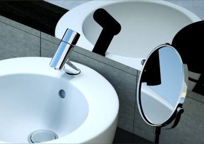

Hello to all, first to ask for pardon for my english, since it is translated by translators of the network. The motive of the consultation is that as it can turn in the photo that I attach, the scene is that of a bath, with wash basin and mirror, so much in the wall as of tablecloth, where it can there turns that the faucet and the wash basin reflect in the mirror. The problem is that the metals that are reflected in the mirrors do not have reflections, apears in black. How can I solve it?
Thank you
Problem with reflections inside reflections

You should try to increase parameters in octane settings > kernel. Especially 'maxdepth' if you work in pathtracing or 'specular depth' if you work in directlighting. I'm not at the front of my working computer, i'm not sure for the exact parameter names.

Thank you very much atome451,
I change de settings from directlightling to Pathracing and it´s works fine, now there are reflections inside reflections.
Thank you again for you fast reply
