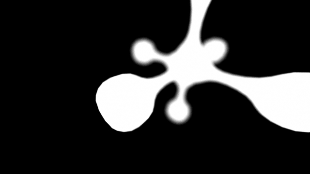

This is what I'm trying to achieve:
item/material 1 mask
item/material 2 mask
