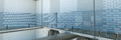

I've got a small problem.
I'm trying to create glass material like the one used for upper level in this image:
http://www.home-designing.com/wp-conten ... ayout.jpeg
I'm using a box with glass assigned to it. IOR is at 1.5, the rest is quite basic.
What I get as a result is huge refraction inside the glass. But if i take refraction to 1 - glass is barelly seen.
What settings should I use?

do you have phong tag on this object?

You are the master!! :)
Yes the phong tag was the problem!
