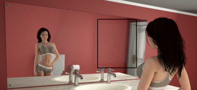

So i have a scene that has quite a large mirror in it, and i am using emitters to light the scene.
I have set all the emitters to Opacity 0, yet due to its position, one emitter in particular causes a reflection in the mirror. Not a solid reflection, but a cloudy one.
I have since re-arranged the emitters so none are in positions to cause these reflections, but for future reference, is there a way to prevent this from happening?
Emitter reflecting in mirror

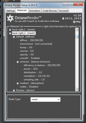

Have attached screenshot of the effect, and material node of the emitter in question. Hopefully you can see the effect in the screenshot, this is a quick re-creation to duplicate the reflection. I have outlined it in black - emitter is slightly smaller than the outline

Does setting the diffuse color to 0, 0, 0 help?
does not seem to have any affect at all, at least not a noticably.
I did try the different kernels, it occurs in both PMC and pathtracing, but not in direct lighting

I just setup a test scene to try to simulate this and could not reproduce the issue you are having.
Is the emitter ON the back wall, or is there a gap?
If you remove the figures from the scene, and just have the mirror, back wall and emitter does it still happen? If so - would you be able to post the pz3 file pls, and I can have a closer look.

To me it looks like you didn't hide a material (looks like it has a frame material left) or the emitter is a strange made prop (might have more than 1 polygon too close to each other).
Try adding a square with only 1 polygon (single sided). If that works, then your current emitter is the problem.

Prior to my lame SSD failing on me, i did check to see if the emitter was colliding with any of the walls. It was close, but not touching.
It might be the emitter being more than 1 polygon - the scene had originally been setup using a pre-made IDL dome and panels for poser, and when i decided to use octane for the scene i just used the IDL panels as emitters. However i know that if i tried to look at the emitter from the side, it vanished.
