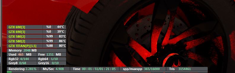

I noticed that not all my graphics cards are being used in the plugin . Anyone else having this problem?
