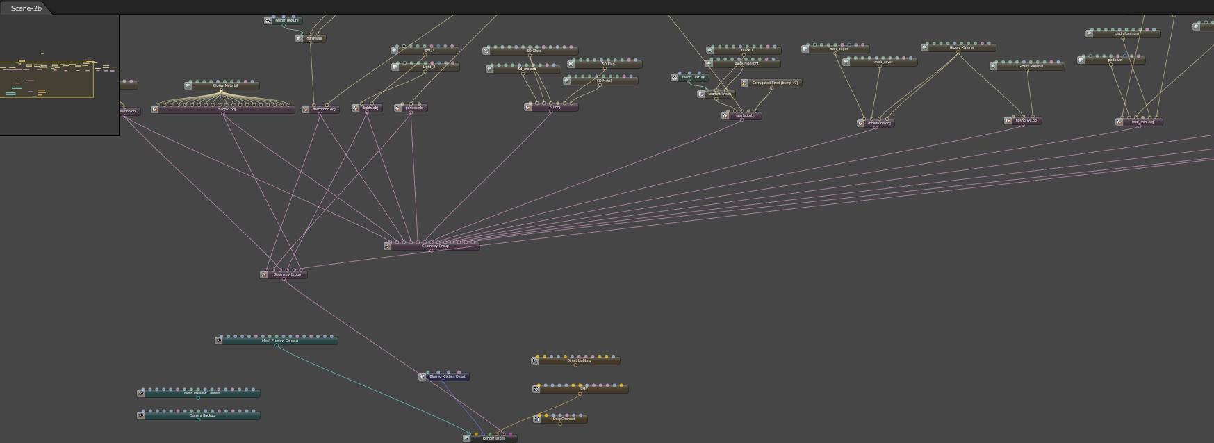

The thing I like about the network layout of nodes as opposed to the tree layout is that I can have different configurations at my fingertips and quickly connect and disconnect the nodes to try different scenarios (see pic) But really, now that I have gotten back into the groove, my request to have the Rhino plugin export to standalone wouldn't be much more helpful than simply exporting the .objs manually, except maybe to get camera positions synced between the two programs.

face_off
Posts: 15714
Location: Adelaide, Australia
You can cut and paste any node and all it's child nodes in order to move multiple nodes around the material. Also, Otoy have stated the the ability to export from the plugins to Standalone may/will be supported in the future. The main issue is you will get a jumble of nodes to sort through. I have a Poser scene which produces 20,000 nodes - so imagine working with that in Standalone!
