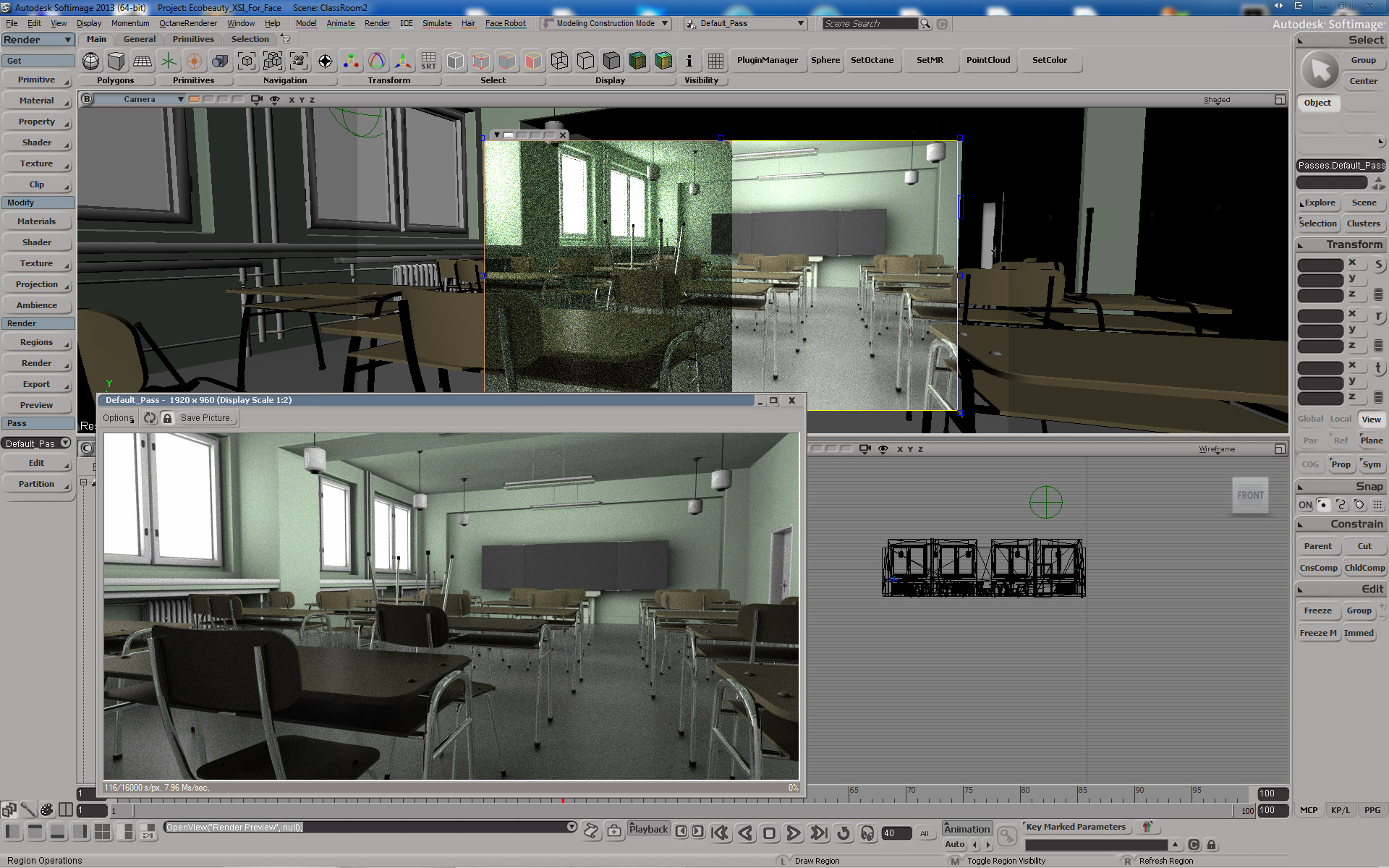

face
Posts: 3204
Location: Germany
Ok, here is an update on which i´m working on.
With a big help of Eric Mootz, i can now use the original preview window.
It downscales now perfect and the artefacts are gone.
Also the Render Region is working.
The disadvantage of this functionality is, the preview info options and preview alpha options are gone.
There is no histogram, no advanced renderinfo and no alphachannel.
Maybe i can implement something similar.
But at next i will resolve some other issues.
Let me know when someone missed this preview infos...
