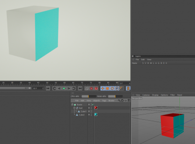

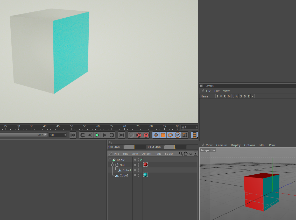

I have simple boolean issue.
When I place materials on the null Octane does not render the cube1 in red, but grey.
But placing the material straight on the Cube1 polygon, it renders well.
Cinema renders well.
I need to place materials on the null instead of all the polygons.
I am using R14 with octane 0.7.2B SDK 1.2.

After updating octane:
Issue solved in 0.8.2 SDK!

If in the event that this can't be dealt with in a timely manner, simply using face selections in the Selection field of your texture tags will achieve the same thing with one cube.
