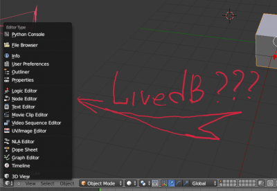

But LiveDB....
Can I get a *.zip instead *.run ?

kaiwas
Posts: 44
Joined: Thu Jul 11, 2013 7:35 am

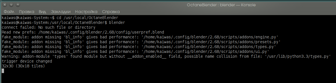

mac3d wrote:hello kaiwas
You run blender from usr/local/Octaneblender?
no. from / usr / local / OctaneBlender not start
Addon copied to another folder. either starts with the replacement of the executable file.
Kubuntu 12.10
Kubuntu 12.10
It seems that you are runing your default blender with this command. From /usr/local/OctaneBlender folder type
Code: Select all
$./blender
NOT
Code: Select all
$blender
