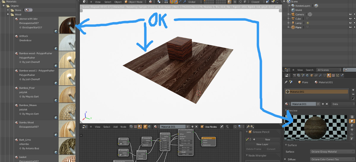

Just select the object and press the little button "Get item" in LiveDB.
I have intentionally made Drag & Drop not working, as to make it work all the standard Blender space editors should be changed to make them know about LiveDB. But it would be too much for just the plugin, as mantaining of feature Blender releases would cost too much resources for the plugin.
If Blender Foundation will like LiveDB space editor as universal feature (I intentionally made it universally working with different servers and later it will work with local database, and it's name does not contain "Octane" ) - they can include it in Blender trunk, and in this case all other space editors can be changed to catch Drops from LiveDB...

Just clicking the "Get Item"-button is not right. 1st we have to add a standard-material to an object.
If this is done "Get Item" will work- before nothing will happen ;).
Can you please explain it a little further?.. Perhaps some examples - how you want it should work?..;)
