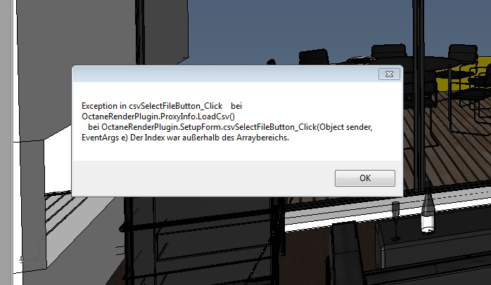

during my latest test I tried to attache a csv file to a block and came across this error :
since the csv was quite massive I wonder if there is some kind of limit on how big these kind of files can get...

Was the CSV file definitely comma separated? How many transforms as it? I've tested with 50,000 at some point and it was OK.
Would it be possible to send me the csv file pls?

700,000 transforms! There are 2 issues 1) there will be a finite number of transforms you can load into RAM (I don't know what that number is, but I've only previously been able to load 50,000, so 700,000 is way out there), and 2) you need to multiply the number of transforms with the number of polygons in the OBJ you are scattering to get a total polygon count that Octane has to render. If you have 10,000 polygons in your OBJ, that's 70,000,000,000 polygons, and you probably need to expect some problems with that.

The issue is that the plugin has an internal limit set for transforms of 10,000, and the exception was being raised when you hit this limit. I have fixed the exception, and increased the limit to 1 million transforms. I was able to get your 700,000 transforms onto a 70,000 polygon object, and the viewport opened!
The above change will go through with the material integration release. If you need a big grass transform prior to then, I suggest 700 blades of grass transformed 10,000 times.
