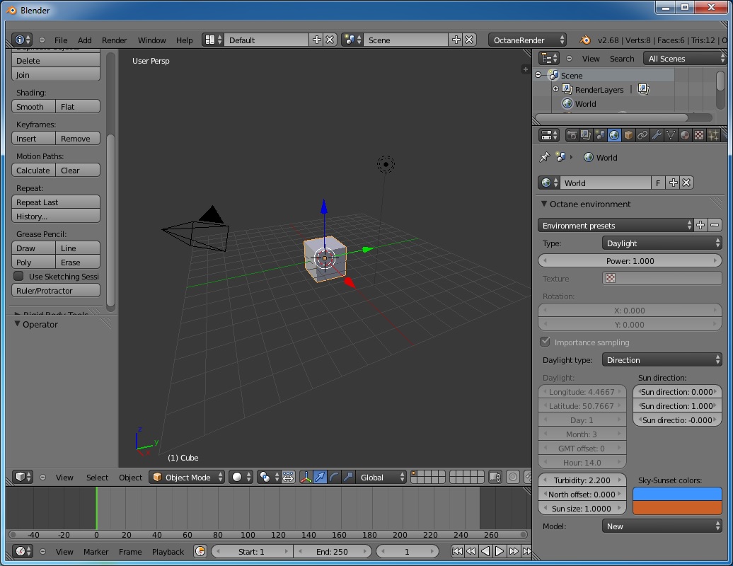

i just bought the Beta-Plugin for Blender and i already go some problems with it. If i am rotating the sun in the scene the live-render window tells me "Waiting for image" since a couple of minutes :( and the picture does not update.
Second problem with rendering final images:
If i press F12 to render a final image i get the error:
Code: Select all
Octane: WARNING: only node-materials are supported
Octane: WARNING: only node-textures are supported

Hi Welti,
Does the plugin work ok with a simple cube?
The warning should not stop it rendering. It's just letting you know that there are some materials in your scene that have not been setup with a proper Octane material.
How are you rotating the sun? Are you using the octane sun direction fields?
Chris.
