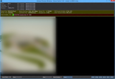

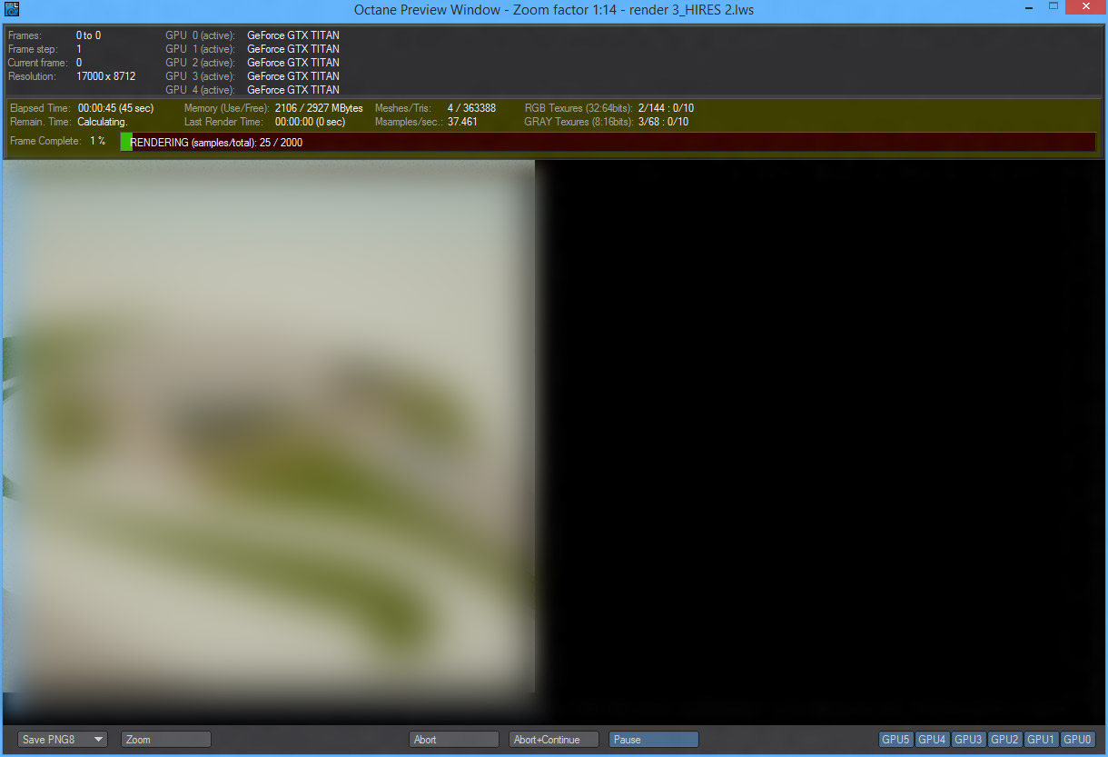

I'm having problem rendering an image in higher resolutions.
Initially I was rendering it at 2752x1416 and it all went fine. Now the client asked for a higher resolution render to put it on a big billboard so I upped the resolution to 1700x8712. IPR sets the correct aspect of a preview window and it all renders fine. But when I use F9 rendering, the render preview window sets the correct aspect but the resolution and zoom of an image is wrong. In X axis the image is twice as small and in the image I can see too much in Y axis as if the zoom factor became smaller.
I need to provide the client with this image ASAP, is there a quick fix to render it properly ?
It renders fine if the X resolution is around 9000 or less, if I go bigger then 9000 I get those distortions.

If I set it to F9 render at 20000x10274 I get a 8192x8192 resolution image.

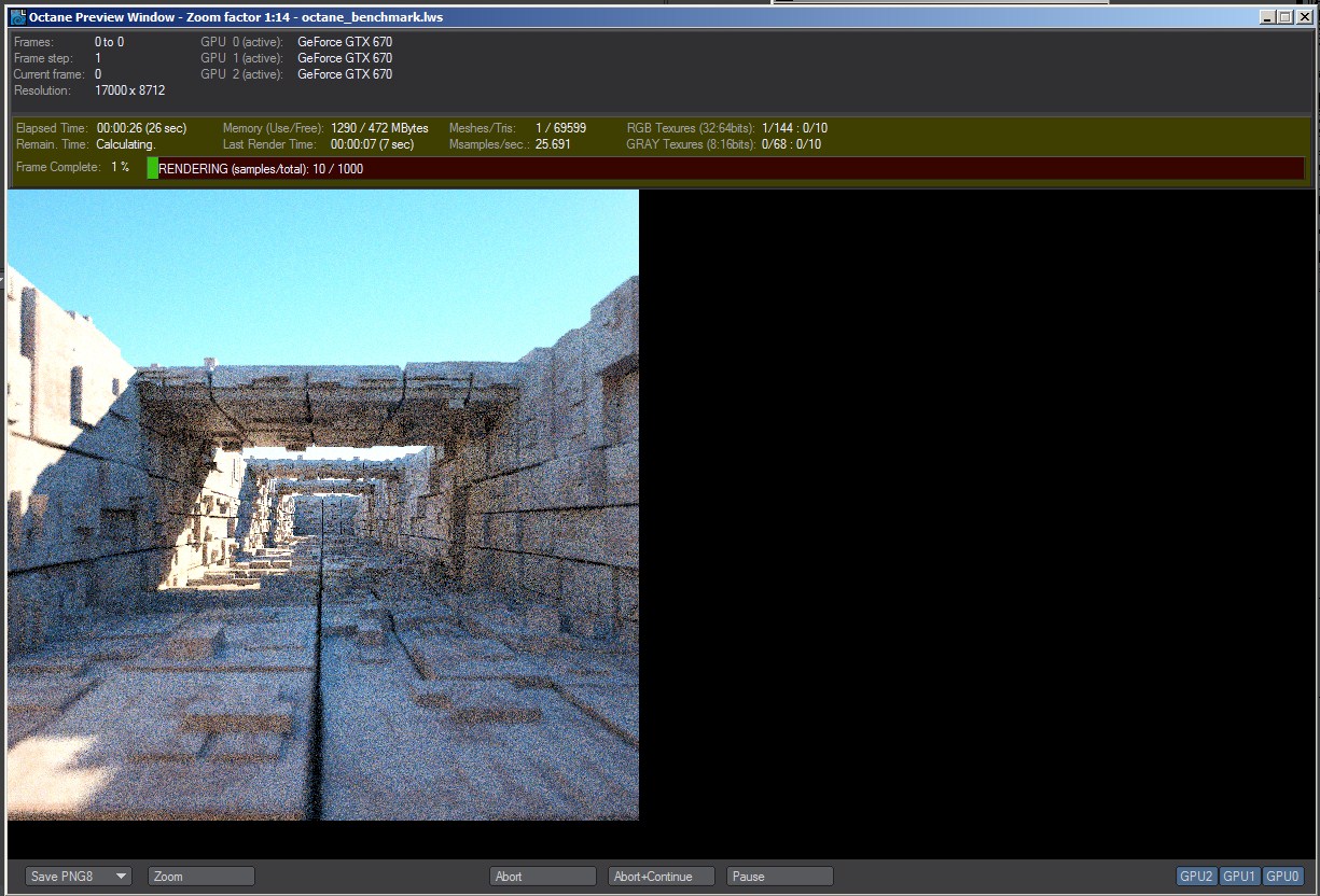

I'm fairly sure LW used to have a render limit. It may even have been 8000x8000 so it could be that. Try a non octane F9 at the size you want to see if it's a LW issue.
There wer plugins to split up bigger camera sizes, but dont' remember what they were.

Boris, you can't split this bad-boy in two with render region?

Ok, thanks for getting to the bottom of this. I will use limited region to render 4 images and then stich them in PS.
