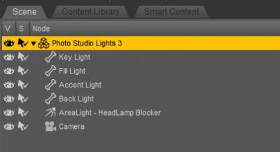

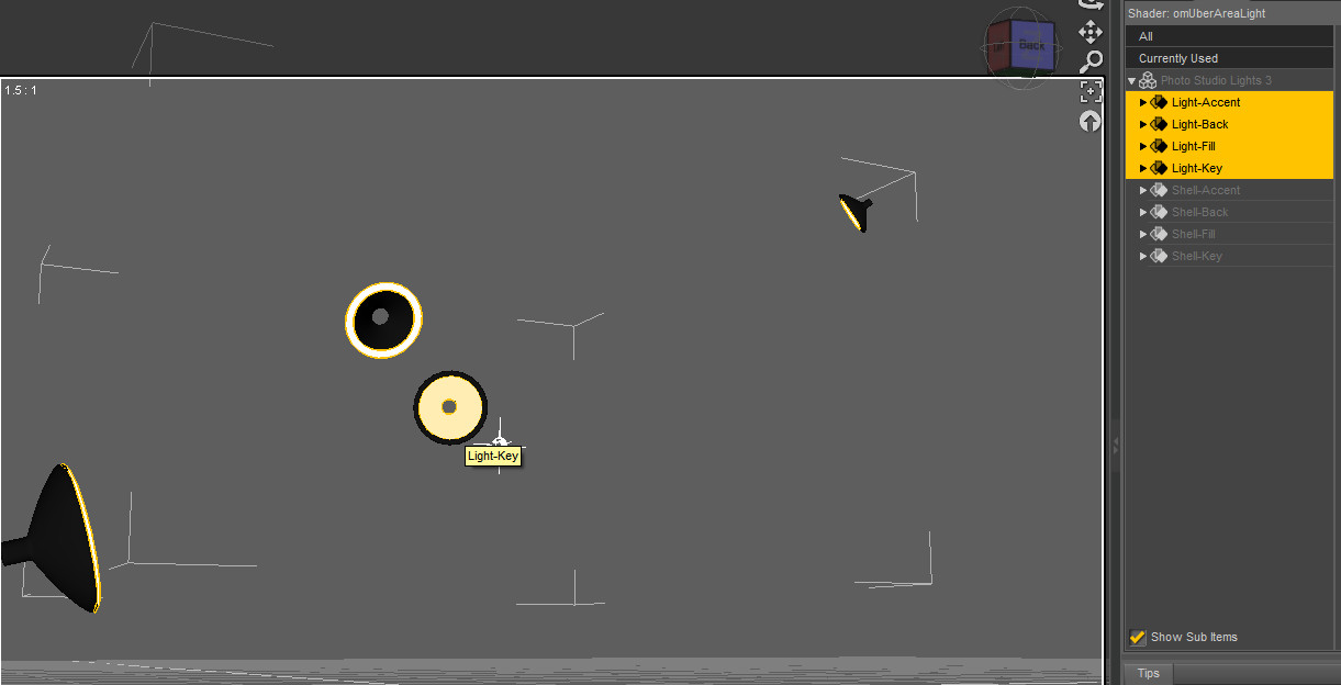

The product (or at least the one I own) consists of a figure loaded into the scene. It is 'rigged' with each bone comprising one of the lights of a studio setup, with initial positions being a 'standard configuration'. Each light comprises the geometry of a physical lamp, with each having two surface materials: one for the shell of each lamp and one for the actual light/bulb/light-emitting part, and it is that part that has the UberArea light shader applied to.
In theory all that would be required would be to have the prop/figure in the scene to be exported to Octane and to convert each/any of the light surfaces to being light emitting.
Showing the four lighting surfaces selected
The figure, showing 'rigging'
