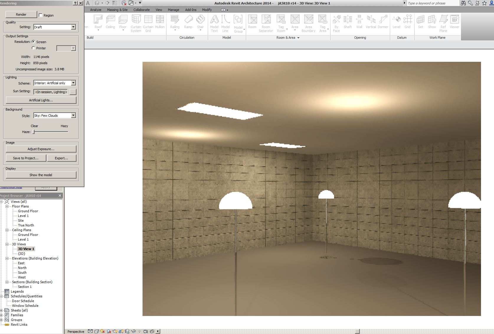

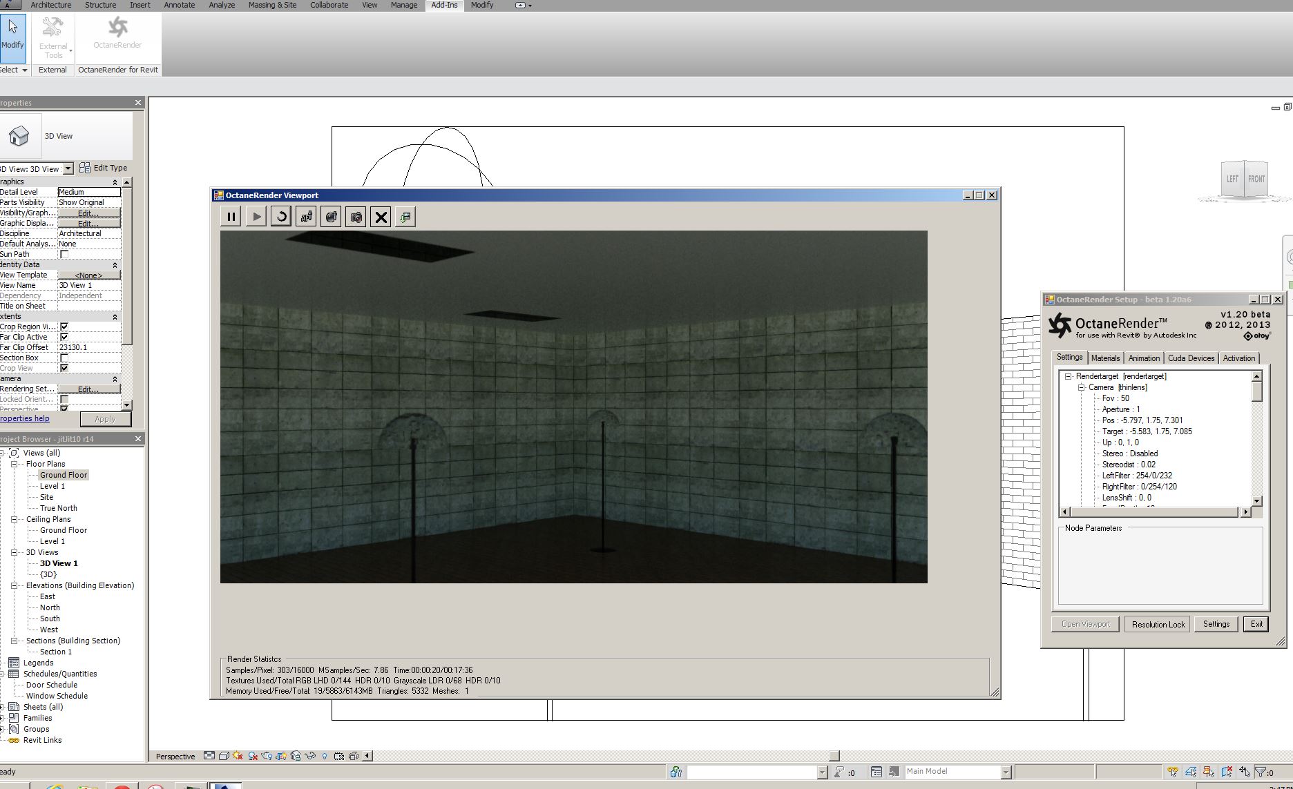

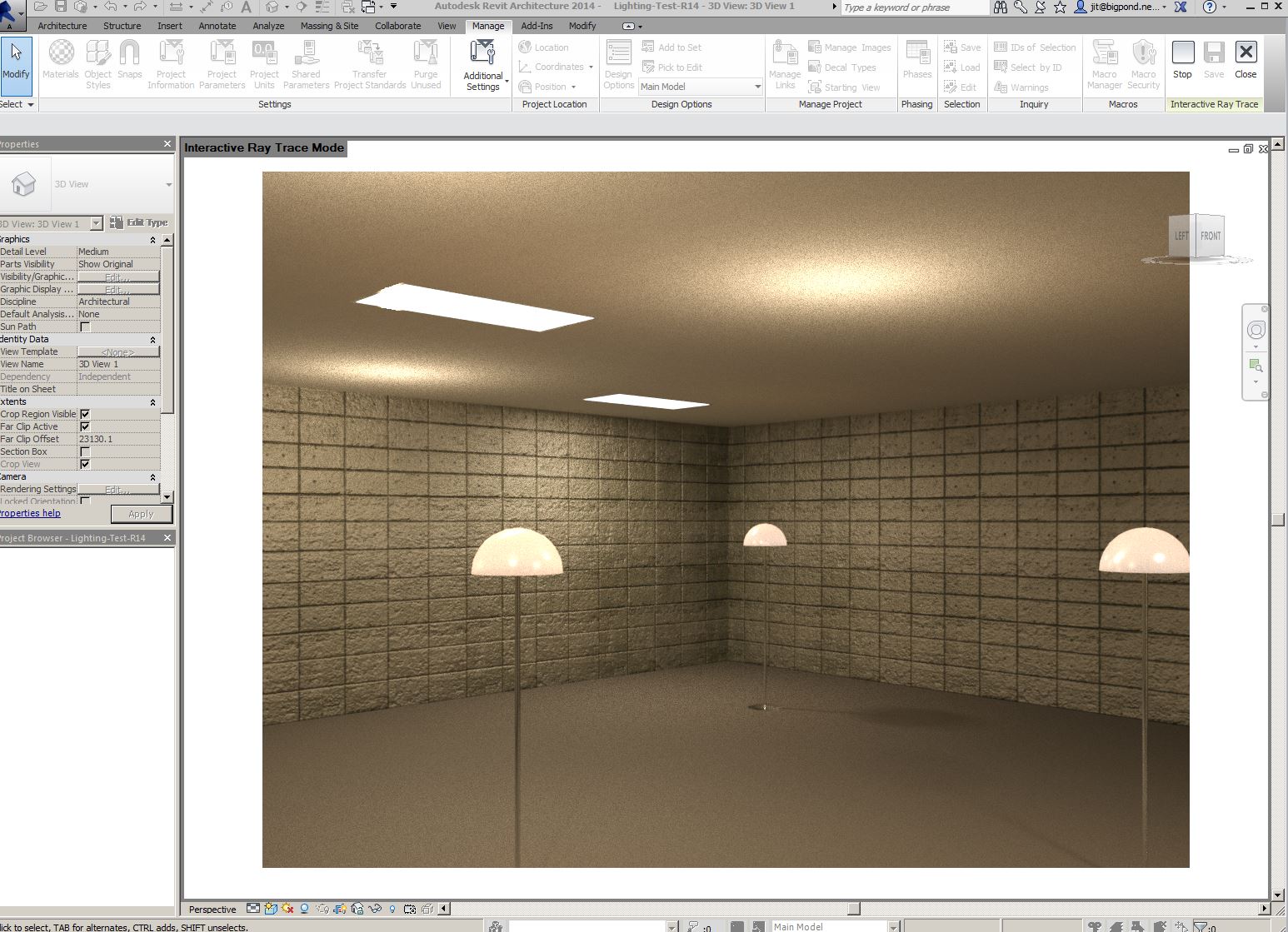

After having followed the notes here (http://render.otoy.com/manuals/Revit/?page_id=79), we still can't get proper lighting going.
Here are attachments showing a simple room rendered via Mental Ray, Raytrace, and Octane. Mental Ray and Raytrace clearly shows the lights working. We're doing interiors with no natural lighting.
Mental Ray
Mental Ray
Raytrace
Raytrace
Octane
Octane

face_off
Posts: 15811
Location: Adelaide, Australia
i have investigated this with the sample scene, and it is actually a plugin problem on Revit 2014. I have made a fix and will post it in a few hours time. My apologies for not picking this up earlier.

Here is the update that should fix this issue.
Download Link (for 2014 only for this test version)
- OctaneRender for Revit 2014 1.20.1 beta (64 bit)
I found that these sort of emitters render slower than daylight and IBL, so turn caustic_blur right up (to 1?), and consider tweaking the emitter material (select via the material picker dropped in the Viewport) - try a very low opacity - maybe 0.05 and reduce the intensity of the diffuse pin. It depends what look you are after...
EDIT: For your test scene - you will need to select the emitter materials (via the material picker) and rightclick the tree and "Reconvert from Revit", to replace the emitter material with the corrected version.
