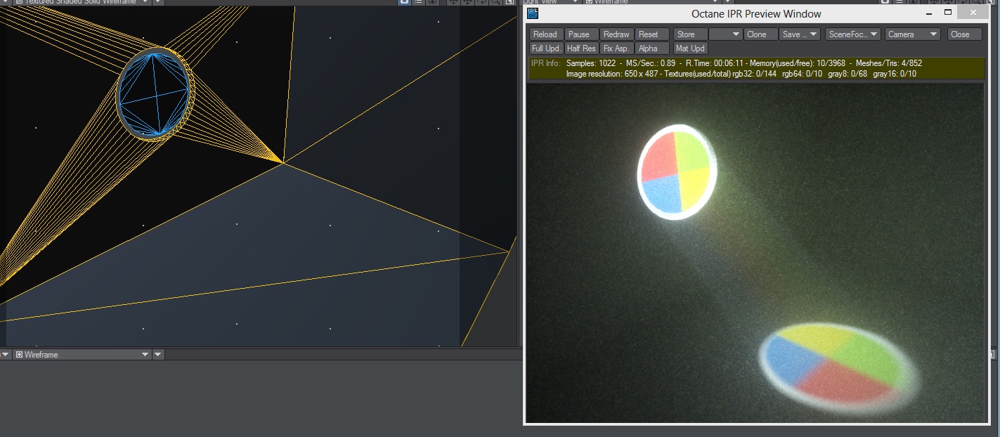

Are there any LW sample scenes showing "Volumetric fog and lightshafts" from the 1.20 release?
I'd like to have a shaft of light coming thru colored glass - and also be able to create a spotlight that uses volumetric fog to get that cone of light effect (if that's possible).

Here you have a very simple scene that show this effect to play with it. The trick is the sphere with inverted normals parented to the camera. This sphere has the scattering material.
-Juanjo

I've not had much success duplicating the 'OctaneRender Standalone Tutorial: Sunlight Rays / Fog Volume ' http://www.youtube.com/watch?v=MqOZp77ZSLg which uses a stained glass image, path tracing, reflections on the wood floor, candles, etc.
The sample you uploaded in this thread was very useful (especially as it went in a different direction and used Octane differently), but ... I can't seem to modify it to give the very cool look from that Sunlight Rays tutorial.
Would it be possible to create a LW scene that matched that tutorial?
Starting from a known good state is very useful where small changes in parameters can have a large effect on the output.
And having an actual LW scene with all the nodes and objects setup (I'd never have known I needed to reverse normals just by looking at the tutorial) is just invaluable.
