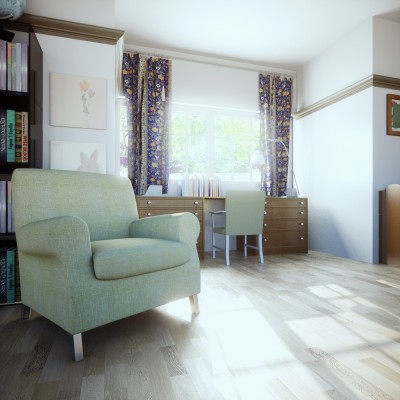

I like those Paquito!
Amazing speed. Can't wait till PMC can render this fast!

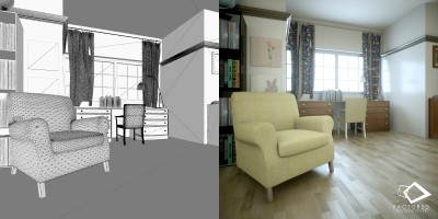

Why do you publish the unfinished works in gallery? This images is very noisy! I think WIP is better place for noisy renders. Or wait little bit more time for clear image. Few minute will be enought for better result.PAQUITO wrote:Another version, now with daylight.

Nice work. First is lit with an HDR image if I understand correct?
Why shows the wall differet strengh of reflection? You changed values, right?

First one is lit by a cool emitter in the window plus a pure white environment, thats all.
Second one is the same, but changing the environment with the daylight system. I don´t remember if I changed the values for the wall, I guess so. Anyways, the second shot is heavily retouched later, so things can look way different that way
Thanks. I have to do some interior renders too and think about doing them as a movie because they are integrated into one. I thought render-times may be too long but your image shows well that it is not so much work to do a efficient light-setup with very good AO output and may be een rendered over a night or two.

A few things:
Material IDs of the picture on the top right hand-side are inverted (picture is on the frame, solid color is in the center)
Curtains are too close to windows and therefore the geometry disappear in the window sills in 3 spots (left curtain: top and bottom, right curtain: bottom)
Cabinet on right hand side seems to be on the wrong side as we can see the grooves of the drawers facing the wall
Molding stoping at the top window sill is a bit weird
