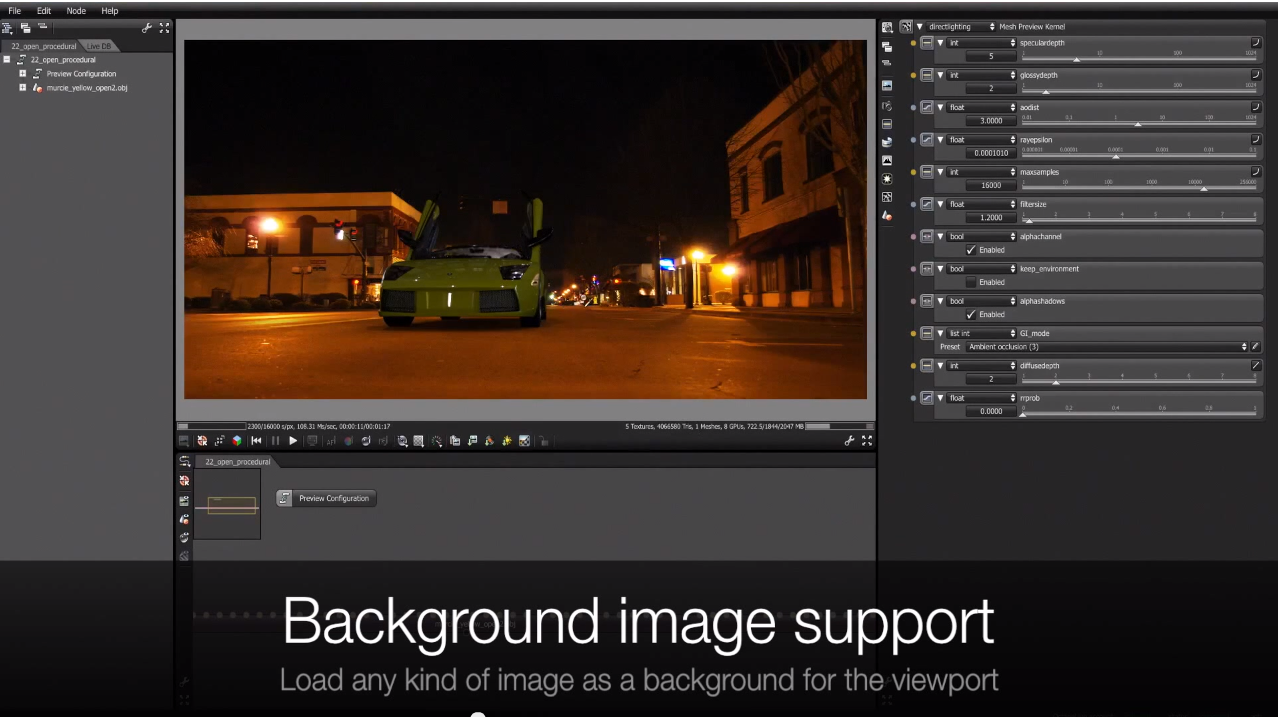

this feature not depends to sdk, but we have a uncompleted support. Put a standart material with png/tif/tga image to background/foreground object and start live viewercbmotion wrote:sorry its me again - just saw a video with the 1.2 satnd alone
there is this background image icon - to put a flat image in the background -
is it in your plugin too?
