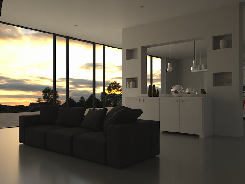

						Great images Daveyt, i'm a fan of DL to.
The pmc 3d are very good.
The first one is a bit dark but the 2nd looks really nice.
Can you explain what you did?
Resmas
Best regardsI've added a day light pass, its a little better now.

Hi Resmas,
I used a technique that many people are using at the moment
as octane does not support hdri and day light in the same pass.
first you render your image using a hdri, then render it again
using the day light environment.
you then mix the two images together using gimp/photoshop
look for a user called paquito he has done a video called mixing hdri and sky
in the forum gallery, he explains it well.
regards
regards
