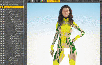

Take a look at the GIF image below. (image click!)
How can I fix this?

linvanchene wrote:
withgoodman wrote:Take a look at the GIF image below. (image click!)
How can I fix this?

But I know it is.
I would say the problem of OCDS.
Look at the second cut of GIF images.
When will see what the problem is continuing.

This suit away from the body by using the displacement map. But Octane render is not available displacement map. In this case, it can be solved by using Push Modifier or Smoothing Modifier.
