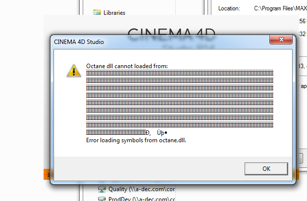

I don't get it. I installed the .69B as per the instructions on the first post and now I am getting the attached error when trying to start C4D. Similar error and no start using the R14 or the R14 fast. Please help!

possibly it's a plugin conflicting. Check your other plugins, and try to manually copy libs64 files to main folderadecemployee wrote:I don't get it. I installed the .69B as per the instructions on the first post and now I am getting the attached error when trying to start C4D. Similar error and no start using the R14 or the R14 fast. Please help!
