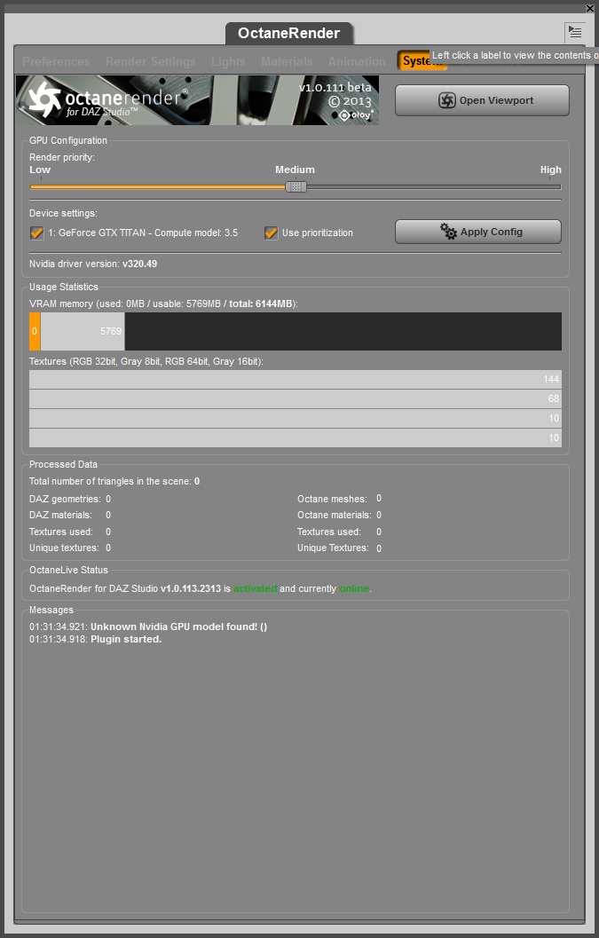

can you please check if there are any suspicious lines in the message box (system tab)?

I updated the nvidia drivers and installed the plugin update. I'm currently using Nvidia driver version v320.49 and OctaneRender for DAZ Studio v1.0.113.2313.
However the plugin is still not working. In the system tab there is a message: "Unknown Nvidia GPU model found! ()."
What puzzles me is that Octane Standalone is running fine...
