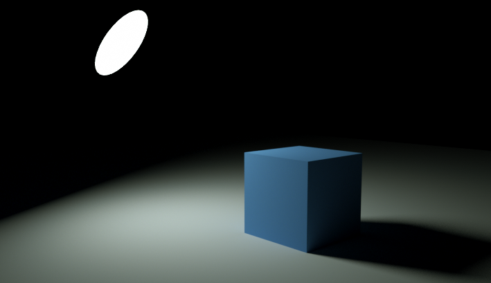

Ok, I turned on my extremely mad C4D skillz and churned out this highly sophisticated scene:
That's the C4D scene file for it:
light.zip
(98.63 KiB) Downloaded 169 times
I was using C4dOctane version 0.69b.
Since I have never used the plugin before I stumbled over three things:
- The light must be an area light. You have to explicitly switch to type "Area" and give it some reasonable size. (Octane doesn't support point lights, because in real life there ain't no such thing like a point light)
- By default, a grey texture environment is used. To turn it off, I had to create a Sky object with an Octane Environment tag and set its power to 0
- By default, the light source emits light but is invisible and needs to be made opaque if you want to see it. You can set its opacity in the Octane LightTag.
But all in all it was working quite well considered that it's current version number is 0.69 and it took me only ~15min.
Cheers,
Marcus

Marcus, thanks for taking the time to post that file. I updated the stand alone and the C4D plug in as well.
When I first bumped into the issues, I had generated Octane stuff using the drop down menus on the Viewer. FYI that light was set for area light and shadow.
This time I just created C4D stuff then added the tags. By toggling back and forth between your settings on lights/camera/materials I was able to successfully get things to work. I found your materials seemed to render faster then the Octane materials I generated. Im not sure why.
