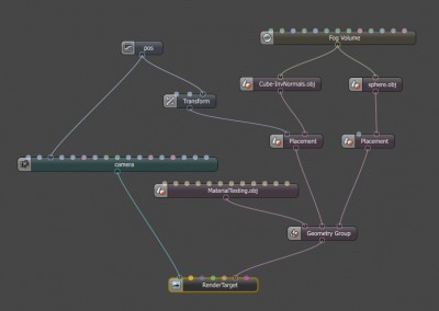

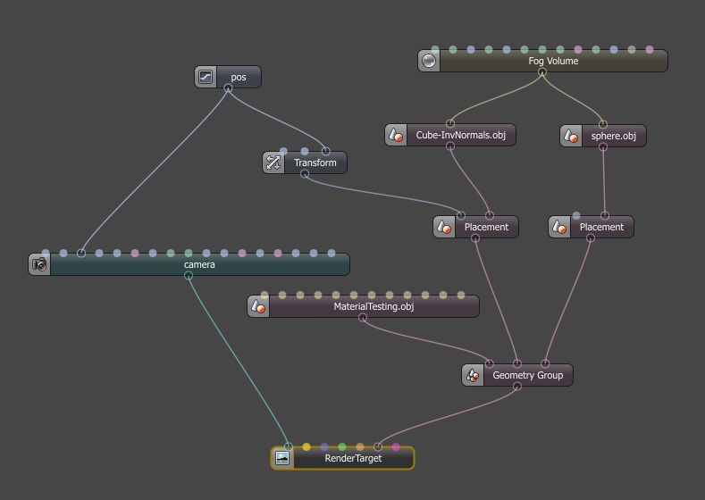

Hi Roubal,
If i understand you correctly, this is already possible. (Perhaps we could simplify this in the future to be automated or easier).
What you need to do is attach the camera's position node to the location of the placement's transform. (Please see attached image).
So when you move the camera, the position is updated, which is also used for the position of the "camera bubble" mesh.
The only problem with this technique is that when the camera exits the fog volume the render is not correct (because the box is still around the camera). Also the picking tools (camera target, focus, materials) will always require using a right click, because there is a mesh right in front of you that will always be selected with left click.
I hope this makes sense.
Chris.
Chris.

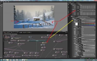

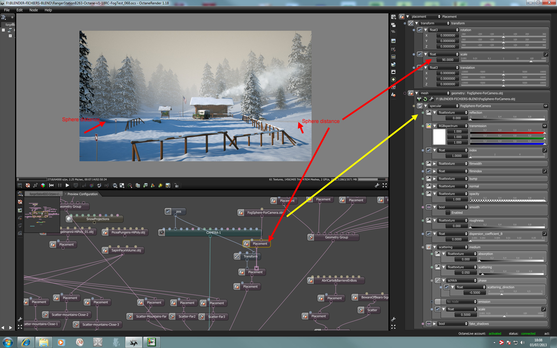

@Fooze : Thank you very much for this answer and solution. I would never have thought about camera transform data usable backward !
As I use a sphere with external medium, I think that my setup will be simpler.
My camera is always outside the medium (inside the sphere), and it worked fine with a static camera. I see no reason that could prevent it to work. I will try that asap !
EDIT : Tested : It works fine !
The scale of the sphere allows to adjust the fog distance. There is a slight dark limit visible on light ground (snow in my example), probably due to AO where the sphere intersects with other meshes. Otherwise, it works as expected !
Thanks again !
Thanks again !
