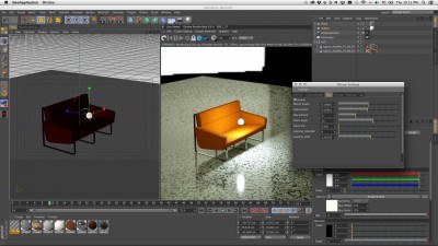

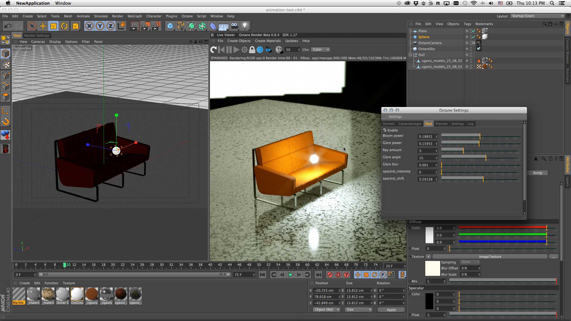

I have a sphere as a blackbody emitter, and post Bloom enabled. Strangely the Bloom makes the sphere appear much larger than the actual geometry. Disabling and re-enabling Post restores it to proper size, but the moment I update the scene or move the camera, it re-renders at the wrong size again.
This is on Mac OSX 10.8.4, C4d r13.061, Octane Plugin beta 0.6.4, SDK 1.17, GPU is NVIDIA GeForce GT 650M 1024 MB.
Mac OSX 10.12.6 / MBP 15" w Touch Bar, 16GB / Mantiz Venus Thunderbolt 3 enclosure with GX1080 / C4d r19 Octane
Posts: 16068
Location: Türkiye
can it enabled post on cameratag?
