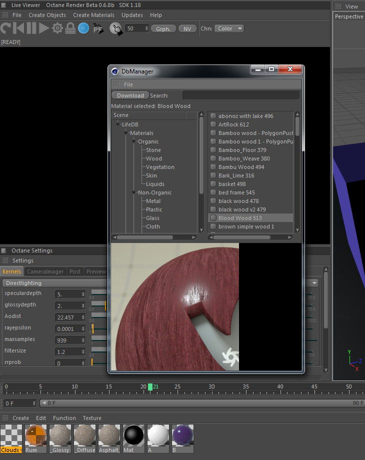

cfrank78 wrote:Hi!
0.6.8a works pretty stable. Only a view crashes and allways with update geometry but only with more complex szenes and only if i use all gpus, even the display gpu.
But one thing i found out was - not any material of the live database works. only a veeeeeeeeery view. But, no leather, no wood, no curtain....nothing. Why is that? In max they work well, in c4d they just look glossy or diffuse......completely strange.
Another point. How can i adjust target lights to be visible in the render view? I tried a view sliders but in the renderview the target and area lights are not visible, just their light.
Kind regards Chris!
dblive manager is working good for me as in picture. Can be a character problem with directories?
For visible lights, you must put octanelighttag and adjust visibility

Ok found my Problems. Had an issue with the directorys!
Now everything works!
