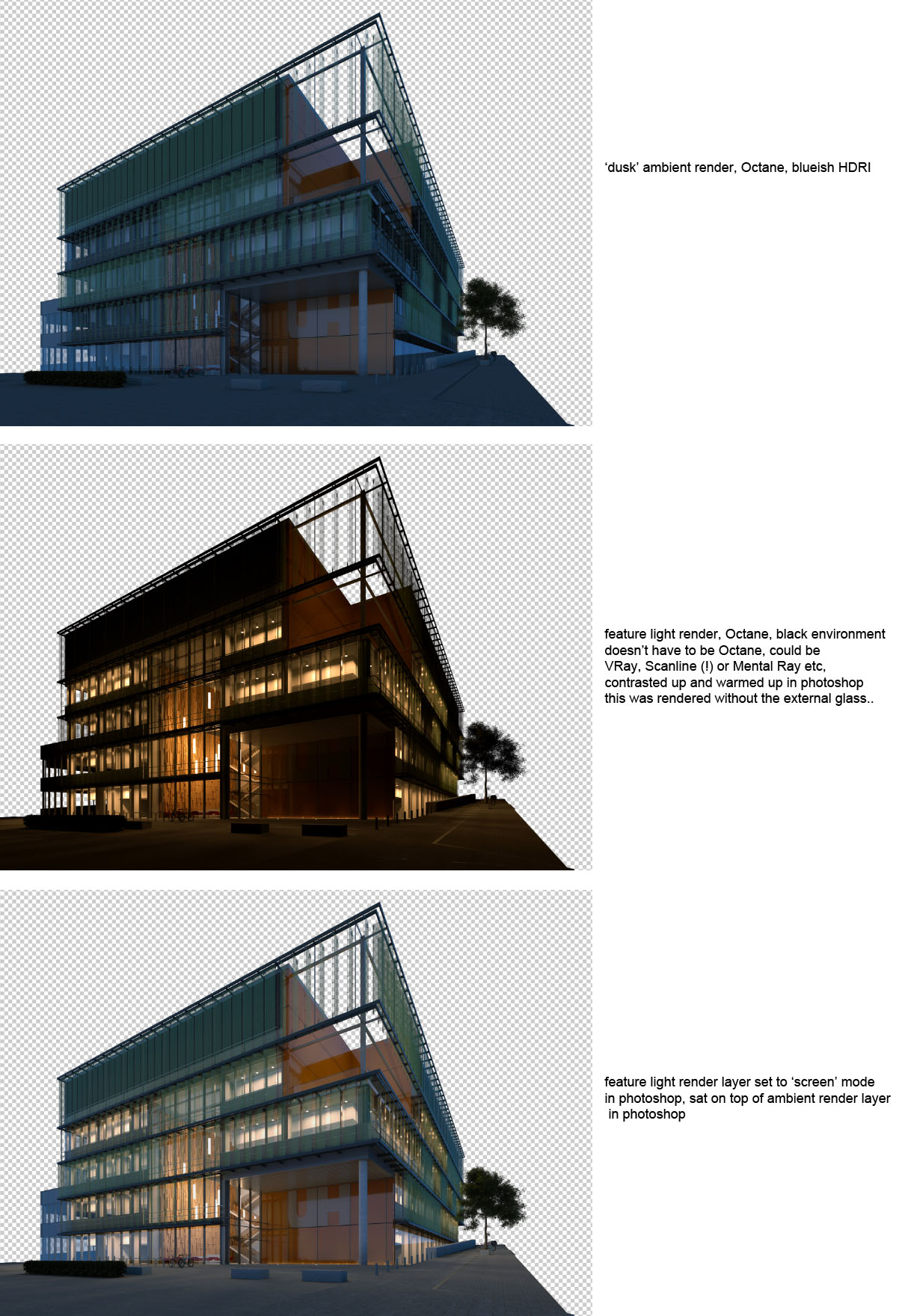

this isn't directly related, but shows the general idea hopefully - although this was all done in Octane
with the camera mapped method, forgot to mention you should probably do an ambient render just lit with a white environment, so its all neutral to begin with, and use that as your camera mapped image for your lighting pass.. could be rendered half res I guess..

Thanks for the detailed explanation !
Looks great indeed !
