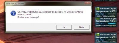

Now I got an API Error on my running animation with 7 external GPUs with the preview rendering and full scene update active. After about 90 Frames of rendering, 1 of my GTX590 suddenly stopped working: First time ever I had this error (0.6.7c), Octane stopped rendering, C4D freezed, but no crashreport. That leads me back to my intuition, that there might be some NVIDIA driver GPU syncing problem going on somehow. Bummer...
Is there any console like program out there, that can read out or log the NVIDIA driver activities? That might help in finding the problem here...

@Chrisvis: this is render settings. http://render.otoy.com/manuals/Cinema4D/?page_id=111
This error window show something gone wrong on render side. Maybe a memory or texture limit problem.
In Octane settings window->others->show log this can show maybe something or check your gpu ram
