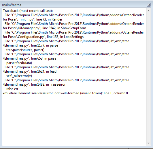

I just installed a new card yesterday. GTX 690. Fired it up. Everything was fine. Fired it up tonight, plug crashed, and now I get this error when OI try to open the Viewport.

Hi. Can you send me the config.xml file from your Poser preferences folder. Then delete config.xml and you will be able to run the plugin. I will fix the root cause of this in the next release. Paul
