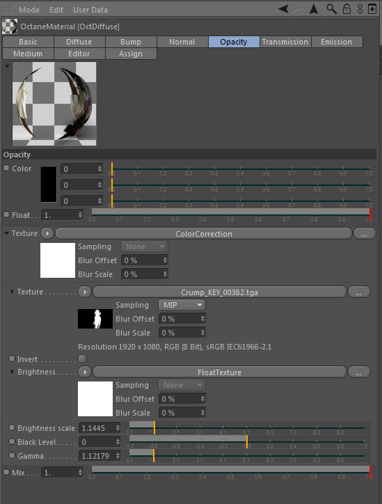

Hello
In this example I have a problem the character is slightly transparent.
My alpha seems to be ok.
Could you have a look on the scene here.
I did a lot of tweaking but I don't find the solution.
https://dl.dropboxusercontent.com/u/200 ... 0Crump.zip
Thank you
Posts: 16066
Location: Türkiye
problem is default Bitmap texture power is 0.9. I have changed to 1.0 my developer version.
If you put opacity texture under a colorcorrection shader you can slightly increase output.
