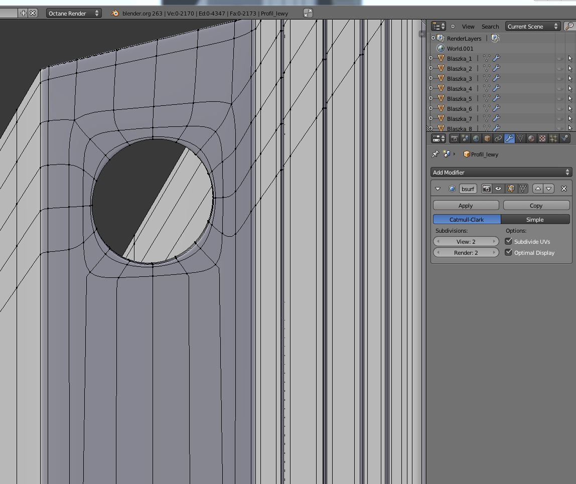

I'm using 1.19 exporter with Blender 2.66 and I have a problem with smoothing some objects. there is a screenshot of a Blender viewport, Octane window and material settings in attachment. When I try to export directly from Blender to OBJ file, the smooth option works fine. Is it possible that it depends on the export settings?

it looks like you have a subdivision surface modifier on in blender. When exporting, it looks at the render subdivisions, is that higher than 0?
The "smooth" option in a material wont give you the look you are seeing in Blender based on the geometry I am seeing.

Thanks for the reply.. but I always have the render subdivisions as default (value=2) and this strange situation appeared first time:)
there is my subdividion and export settings in attachment..

weird. I dont know what could be causing it then.
that being said, did you try adding a new material to the object in Octane and turn smooth on/off?

Yes, many timeskavorka wrote: that being said, did you try adding a new material to the object in Octane and turn smooth on/off?
But you have to add some simple materials to objects in Blender, because if you don't.. all objects will have the same default material in octane, right ?kavorka wrote: I dont use the materials in Blender and export, I do everything in Octane.

I just add default materials with names that make sense.
then do everything in Octane. Otherwise you don't get the instant feedback that Octane offers.
If you attach a .Blend with the object in question, ill give it a look for you and see if it acts the same for me.
