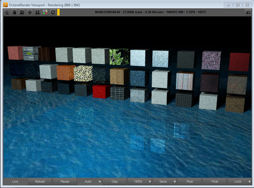

Another thing I am noticing is that the render viewport isn't updating
AND
I have to restart to get it to show the changes

You can select a surface on the right side of the OR materials tab and it won't highlight the octane material on the left.
While I did not notice this (might have missed it), I did double click on a mat and when the NGE was open I was dragging a NEW Diffuse node on to the window when sudenly the mats `root node` just vanished!, sadly I had stopped screen cap at the time.
I am uploading a vid now for t_3 to see as it seems to be a mixture between the issue I was having with the Live db and what you are describing!
Note the changes applied to the surfaces in the before and after (Ds reboot) screen caps!
...(Excluding the water mat/map that I added after screen cap had stopped)...

Ok, since rebooting Ds and reopening this scene, I can NOT drag a mat from the live db on to a surface in the render window.. I get a black circle with a black line through it on my cursor :(
EDIT #2:
Rebooting Ds AGAIN did allow me to apply mats once more but they only showed up in the render window after yet another reboot of Ds.
Before Ds reboot..
Before Ds reboot..
After Ds reboot..
After Ds reboot..
