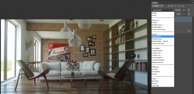

hi all thanks for your suggest and critics!! it's Great !!
Just FYI, for mixing two images I proceed as follows, an image rendered with the sun, disables the environment, an image rendered with HDRI as light source.
Then in photoshop, overlay 40/50% of the first image on the hdri rendering. that's all.
I think I'm right? if you have another trick, I'm interested.
Octane does not handle background pictures you have to fend as we can ^ ^

would that correspond to 'overlay' mode in the english version?
always been curious to how this mix of sun and hdri is done...
