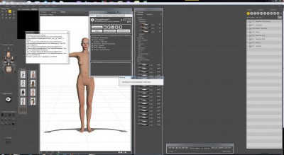

At first run I loaded a V4 figure and hit Open Viewport and then Poser stopped responding.
Last two lines in the log was:
DEBUG:root:init:objectsRenamed
DEBUG:root:Ignoring rename of non figure/prop figure sun to Daylight
EDIT: This was in PP2012 SR3.1

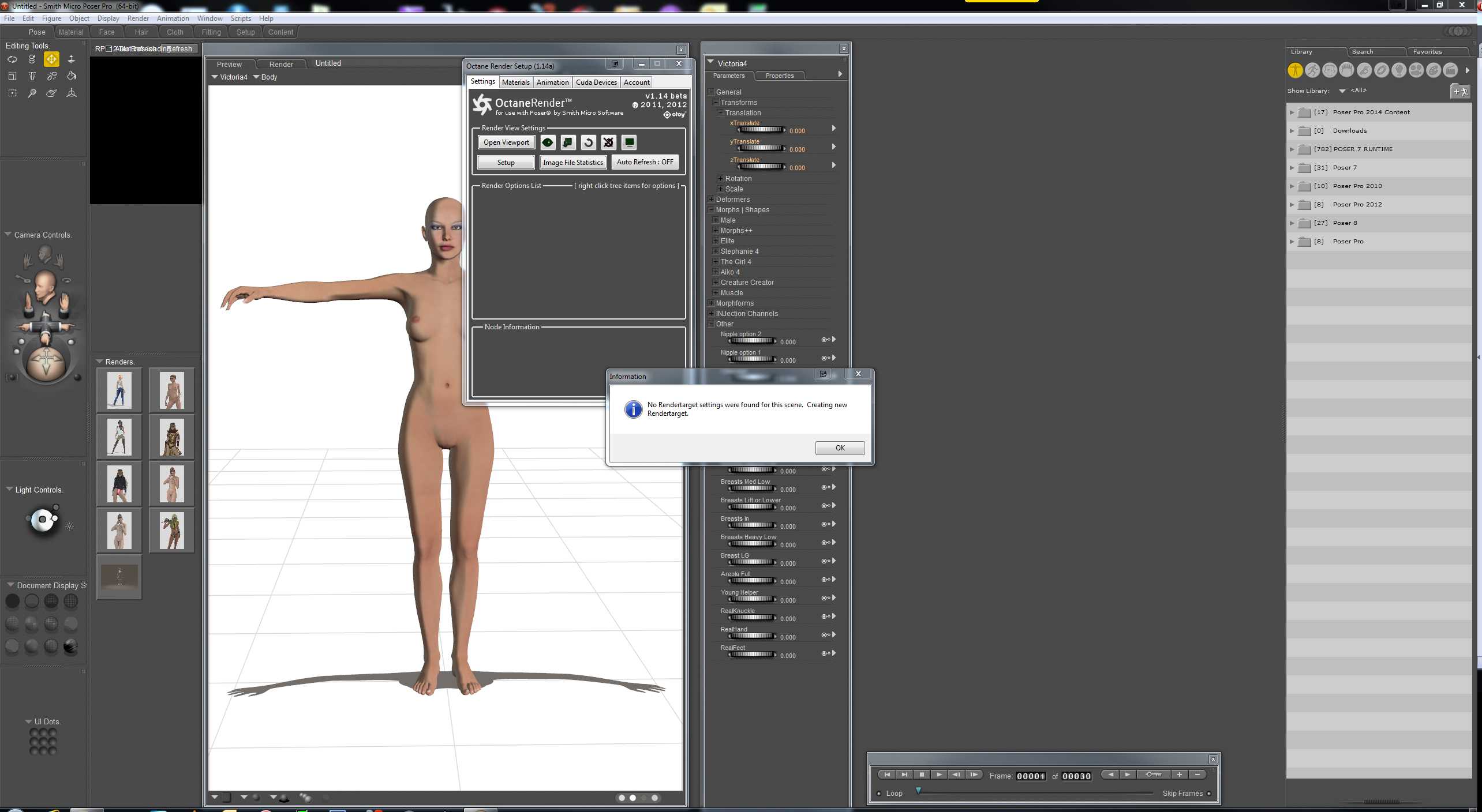

						Cool ... but nah... attached errors on first run with Poser Pro 2014 (64bit)... log file to follow when I find where it is again.

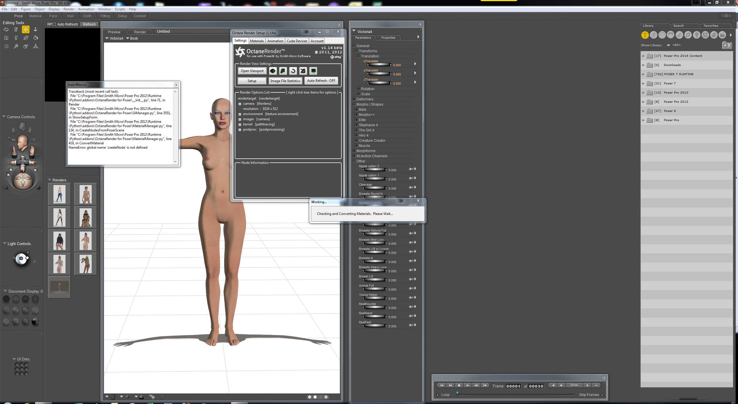

Another V4 load under Checking and converting materials it stopped and I got this:
							Code: Select all
Traceback (most recent call last):
  File "C:\Program Files\Smith Micro\Poser Pro 2012\Runtime\Python\addons\OctaneRender for Poser\__init__.py", line 71, in Render
  File "C:\Program Files\Smith Micro\Poser Pro 2012\Runtime\Python\addons\OctaneRender for Poser\UiManager.py", line 3551, in ShowSetupForm
  File "C:\Program Files\Smith Micro\Poser Pro 2012\Runtime\Python\addons\OctaneRender for Poser\MaterialManager.py", line 134, in CreateNodesFromPoserScene
  File "C:\Program Files\Smith Micro\Poser Pro 2012\Runtime\Python\addons\OctaneRender for Poser\MaterialManager.py", line 434, in ConvertMaterial
NameError: global name 'createNode' is not definedWin 11 Pro | i5 12600K | 32GB ram | 2x GTX 1080Ti + 3080Ti - studio driver 560.94| Modo/Blender/ZBrush/Daz/Poser

Haha Deane.  Unfortunately solving one of the issues was more involved than I thought it would be.
I have revised the original downloader at the top of this thread. Pls re-download and use the new version.
1.14a2
- Fixed issue where converting certain skin materials was throwing a python exception
- Fixed a range of issues associated with adding, renaming and deleting scene elements when the plugin is running. In summary, you can add, rename and delete items, and the plugin should not need a refresh (it will do a refresh automatically if the viewport is open).
