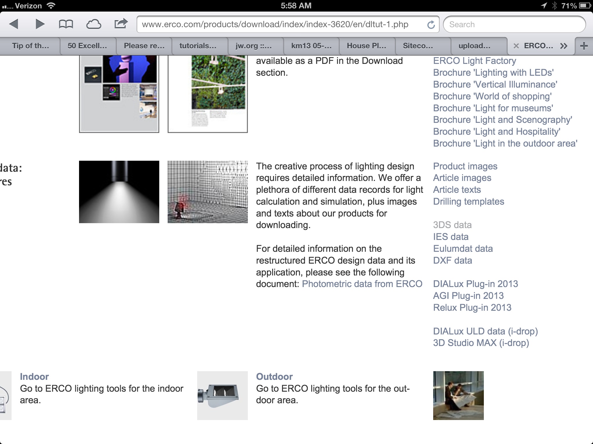

This method sounds very good! Thank you for sharing. The ERCO site is very user friendly to find this information. On this page on their web site:
http://www.erco.com/products/download/i ... ltut-1.php
I found these options: (see screen shot)
Do you select and download: 3ds data, ies data, or 3d Studio Max (I-drop)?
Thanks for the help! I think you may have saved me a lot of hours. I will post my results.

I downloaded all data from erco. if you download 3d models you'll see they are very useful because they linked with assembly and you can change target in some models. if you use this 3d models from site you can turn off original photometric lights and put ies map to sub material of model.
