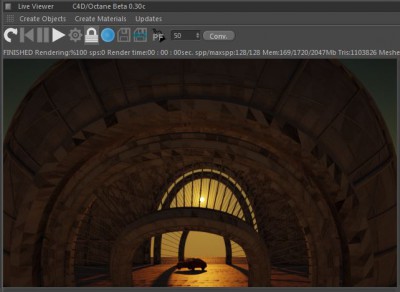

Back to the phong issue again. I tried everything to import this correctly from 3DS MAX as a FBX, then as an object. Tried bringing the phong angle down to 20 and still this. Any ideas?

i'm not sure (it's extremely dark), but it seems more a scale problem than a phong issue this time
what are the dimensions of the car?
ciao beppe

bepeg4d wrote:i'm not sure (it's extremely dark), but it seems more a scale problem than a phong issue this time
ciao beppe
Sorry I dont actually know where to find that info. I generally download a model and then import it into C4d but I dont really know how to set a scale. I have been meaning to find how so I can import all this correctly into the scene. Does this have anything to do with importing in Meters? I know the standalone version expects this, is it the same with Octane live render? Do I need to import everything into C4D in the meters scale for it to show up correctly in the Live render window? I have been importing in centimeters, millimeters, or scaling if it did not look right.

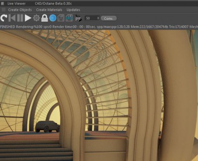

You may be right, I did scale the building down a little in the last photo. Here it is again w/o scaling and it looks better.

the setting of the scale is crucial in octane, otherwise camera, emitters and materials doesn't behave as expected ;)
try to import a 1 meter cube into c4d and standalone and verify the scale, i always work in cm with no issue.
