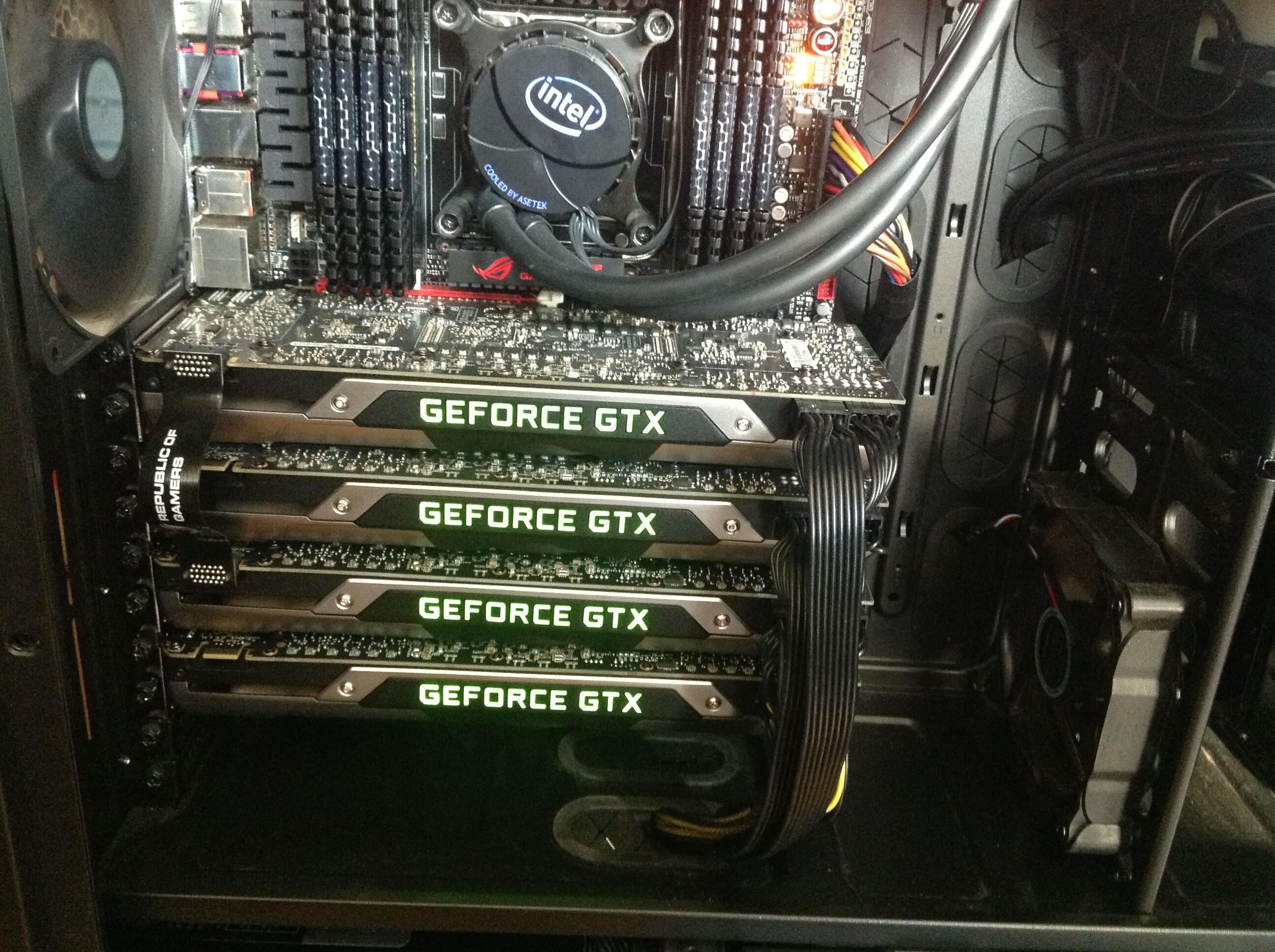

Hi Snoopy
Here is my Rig with 8GPU's
Case: Coolermaster Cosmos II
Mainboard: Asus Rampage IV Extreme
Power supply: Coolermaster Silent Pro M2 1500W
GPU's: 4xGTX 690
OctaneRender® for 3ds max® I7 3960X Asus Rampage IV Extreme 32GB RAM 4xGTX690
