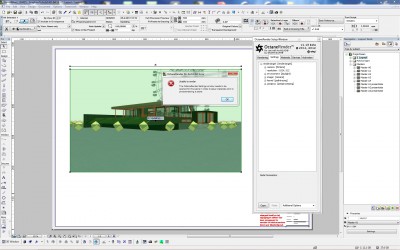

Hi Paul,
I am trying to make and connect rendertargets to views/viewmaps,
but I cannot get the hang of it.
Can you describe the workflow i have to follow,
maybe I am missing the point.
greetz, Jeroen
4090+3089ti & Quad 1080ti
http://www.tapperworks.com
face_off
Posts: 15729
Location: Adelaide, Australia
Hi Jeroen
I suspect the above msg is now fixed in the latest version.
For saving a rendertarget to a view, open the plugin, doubleclick an ArchiCAD view, then you can save that rendertarget to that view with the Setting "Addition Options" command "Save Rendertarget To View". Once you do this, you will see the View name in the root tree item of the rendertarget (ie "default rendertarget [rendertarget]" becomes "Generic Perspective [rendertarget]".
So now, in that ArchiCAD scene, when you activate any View called "Generic Perspective" you will be working with that separate copy of the rendertarget. If you then select a View you haven't saved a rendertarget for, it will go back to using the default rendertarget.
When you do a photorender, you can now select the View to use for the photorender in the Document->Creative Imaging ->Photorender Settings (however I just noticed it's not working - but it will be with the next upload).
Paul
