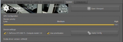

Now with support/control for single graphics cards.. You can choose from 3 GPU config settings ;)
http://render.otoy.com/forum/viewtopic. ... 22#p140022
3 options for GPU config..
