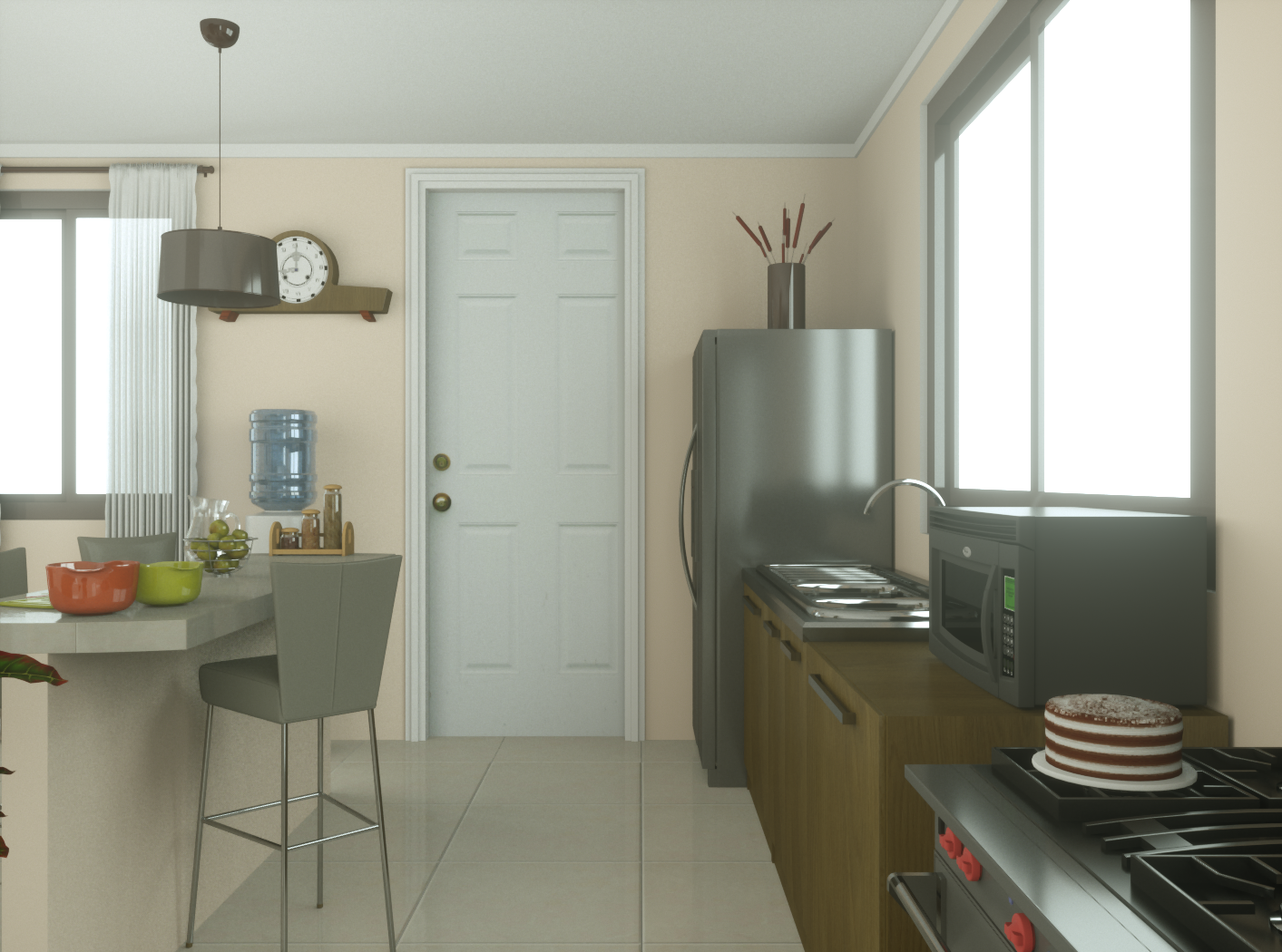

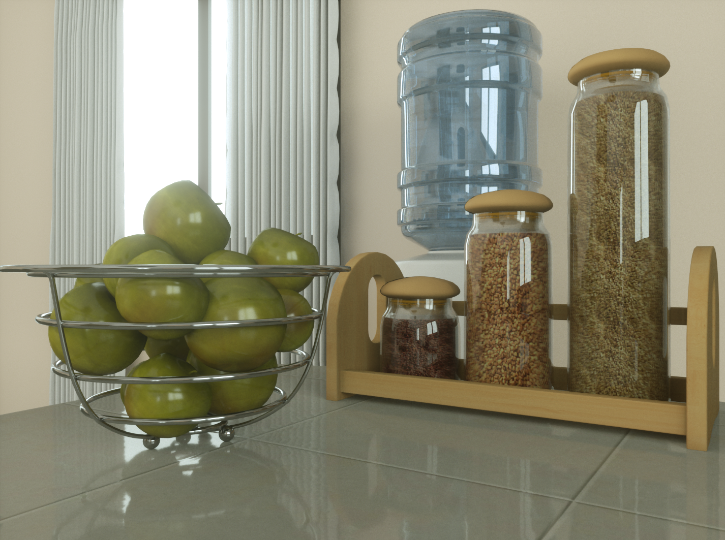

3 new image, directlight, AO, 2000 maxsamples, diffusedepth 8, time 2.30 minutes per image
regards, 3ds max 2013 and octane for 3ds max

thank you paquito, for your tips i can do better image
hi paolo, you are insistent with me to be better and giving tips in every image
i would like have a better illumination but i guess need trick, none octanelights, just emitter in Windows
Something to improve is the distribution of light. It´s overall too homogeneous. You will improve the richness of the scene by setting one light being more predominant. What I would do is the following:
1. Set the windows as emitters in a cool light.
2. Set an HDRI environment as a fill light.
3. Balance the power of both (regardless of overall luminosity of the scene) until you get strong outside indirect light lightning the scene from the windows, and the rest being filled with the HDRI in a more subtle way. You´re looking now only for an intensity difference between the two lights, one being predominant over the other.
4. Adjust the exposure to get a correct overall luminosity.
That´s the general way I work my interiors. Make some tests.

thank you paquito, how i can use hdri into scene with octane for 3ds max ? this images not was done with standalone version
