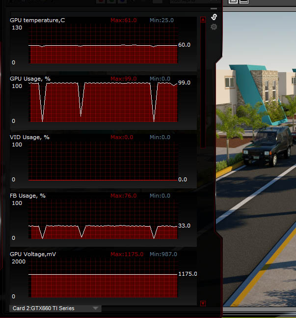

That could be overheating or power supply issue.noelnoel wrote:no problem, you can have, but i find the problem, i cant do renders with the 2 video cards active, if i render with with only one, no problem, but 2 active and freeze.
i confirm this 3 times,

I use the GPU meter to check the temperature of the video card and the Precision X to see the performance of the fans ... if interested to test write me and I can pass those to see which is failing ...

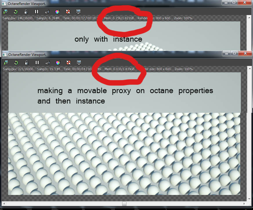

I finally found the problem, not the truth if the program file, but render stop only on final or starting a new frame. (25-35 frames)
you give two opcion, power supply or overheating, neither was the problem, i change the powersupply and the problem still. and place the PC in the freezer. jajaja
the heating wasent, here the numbers but after extensive testing I found that the solution was to disable the opcion autoupdate movable proxy, how i say, i dont know if is and error with all or only this file, the only
relationship i thing is that trees on all my works always i turn into octane properties to movable proxy for to optimize memory, i dont knot why the manual says that an object instance is cloned as one of the ways to optimize memory.
see 30x30 sphere two modes
without that opcion i finally renders 1500 frames.

Isnt there any way to seperate movable objects and instanced but is not movable?? becase i have 10 characters walking under the trees. So when i check autoupdate movable objects its reimporting trees and characters each frame again and again
but i just need the characters to be updated.
A custom tag under Octane properties maybe?
Smth like "do not update after 1st frame"? Maybe stupid idea. Didn't quite think this over.
But we do need a bit more optimised system than it is now. Huge amount of time (when doing larger scale animations) goes to models export.
