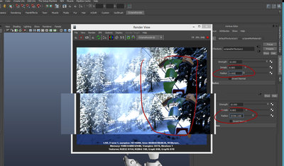

ok let start with teh slider issue..
here a screen shot .. right now i's on teh roughness.. but that also happen to some other slider functions

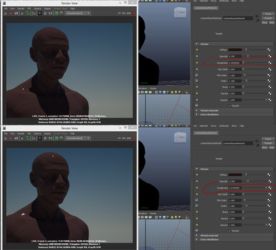

xtrm3d
Posts: 280
Joined: Sat May 01, 2010 7:01 pm
Location: santa monica
another one ...

xtrm3d wrote:ok let start with teh slider issue..
These "min-max" values for the SLIDER are exactly what other users asked me to make a lot of time ago. So, it is intentionally made - changing by slider works from 0 to 0.01, and all other values you enter in this field by keyboard, not by slider.
If the most of users have already changed their mind about this soft-threshold - I can change it quickly, no problem... I just don't want to enter to the situation when I will change it in the next version, and the next day a lot of another users will start complain to the new thresholds...
The reason why all these field-slider thresholds were not changed the last time is simple - already long time NOBODY has written that they do not like it. But from my side - changing it is just a 5 minutes of work, I just need to know that the customers need it.
So, just write here all slider min-max values that are convenient in your work (for attributes you want), and if no other users will object it - I will change them in next version.;)

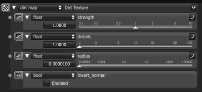

JimStar
Posts: 3812
xtrm3d wrote:and in some instance , some of them go from 0.0000 to 1000 ( not in front of octane right now .. would post screen shot )
On the screenshot you posted here, e.g. the Dirt Texture "radius" value has the thresholds exactly as in Octane standalone 1.11 at the time: 0.0000100 - 100000.0000000.
Hi JimStar,
Actually the roughness slider range was asked to be set where it is back when the engine still had the old glossy shader model and it would make sense to change it back to 0 - 1 now. I guess the rest of us just got used to typing in values since the new model was introduced and never mentioned it. :?
T.
Win10 x64|i7-9750H 2.6 GHz|32 GB RAM | RTX2080 max Q 8GB
JimStar
Posts: 3812
OK, I will change it.;)
Would be cool, if you will write here what slider thresholds will be convenient for you all for perhaps some other attributes - I will change them too in next version...
