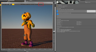

my card failed after a while whilst playing with some settings..
My System:
Intel(R) Core(TM) i7 CPU X 990 @ 3.47GHz 3.47 GHz
Win 64
Nvidea Quadro 4000
daz 64 bit 4.5.1.56

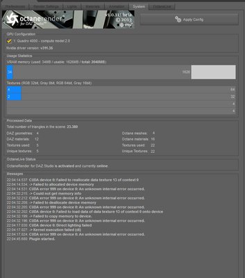

I've attached the log file.
Greetings from Bavarian
Michael

thanks for the info and esp. the attached screenshot - this screen is indeed the most useful to get an overview about what is/was going on.
999 cuda errors are hardware related problems, with various possible sources; apparently undervoltage, overtemperature, pcie bus errors, seldom even system ram problems might cause them. most obvious thing to watch out for would be the temps; since quadro cards usually run on lower voltage (to allow single slot card designs), this might also have caused it.
what will be at least worth a try is to update your driver to the last whql version.
currently i have no clear path what'd be the best way to handle that, so it would be helpful to know:
- do you also use your system with the standalone regularly, and if so, did you have such failures there also?
- did you monitor temperatures - maybe have some numbers?
- was there a rendering ongoing (= not paused)?
- were you able to recover without restarting your machine?
thanks in advance...

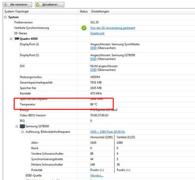

thanks for your answer. It could be the overtemperature that you mean. 95 degrees centigrade is probably to high. I loaded last week the last whql version.
