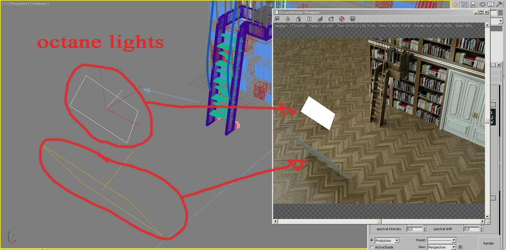

tha plane are an emisor or is Windows light ? i see a horizontal line in the plane
what means this ? hdri but no bouncing light ???

the scene hasn't got any windows, walls or ceiling.
The two light are octanelights (no other lights except the HDR, don't know which orizontal line you are referring to).
as for "hdri but no bouncing light", the AO mode doesn't produce indirect light, the light emitted from the source (emitting planes, light planes, HDRI) after reaching the surfaces stops illuminating (nerby object doesn't recieve light from other surfaces...likes in real life happens and in DIFFUSE, PT, PMC mode happens too)....maybe someone could be more exaustive

ok, send me your scene (you have my email)merid888 wrote:i don't understand nothing, may i send my scene to see it ?
