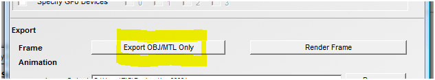

You can simply Export the OBJ/MTL data from the SKP without starting a Octane or a render.
It is simply a matter of clicking the 'other button' ! Once you have an OBJ you can easily make a cmd file that loads it and opens Octane and renders.
To get an example of the cmd code simply start a Render with the Exporter [with settings as you like] AND while the dialog is still open the temporary cmd files that are made with the SKP are available for copying [there are two - a starter and a main file]. Once the dialog closes the cmd file's are auto-deleted. Use the copies as templates to make new ones using your own OBJ/MTL sets that can be Exported without instigating Octane or a render...

Thanks TIG,
Yes I have seen the export button and this is what I'm doing now manually.
The need :
I have a script that use Sketchup Pro obj exporter to create the obj file and that creates command lines for octane render
I would like to use your exporter in place cause the color correction.
I wanted the script to export and render many sketchup files (~100) without manually activating the menu and clicking on the button for each one.
If any tips on how to do that

I don't think it's possible.
It not set up for just one part to run...
You'd have to setup the Exporter for each SKP anyway, so clicking a button is hardly an extra hardship.
There is my stand-alone OBJexporter that is similar, however I don't think it does the Octane specific color correction, so it is little different from the Pro OBJexporter you have !
It'd be possible to set up a Ruby batch file that would open all SKPs in a particular folder, automatically open the Exporter etc [just use the same code that opens the dialog for the toolbar button OR the simple command 'octane'] but you'd need to click the button by hand and how would it know when you are done and to move on to the next one ?
You might be better of writing a simple tool [using IO.readlines(mtlfile)...] to process the colors inside a premade MTL from the Pro OBJexporter...
find all of the 'lines' starting 'Ka ' and 'Kd ', and remake their three RGB values adjusted by r=r**2.2 etc...
Raising an RGB value to the power of 2.2 has the affect of adjusting its 'linear gamma' to better suit Octane...

Hi TIG,
Thanks for your help.
I also found this way :
for each skp file
Sketchup.active_model.set_attribute("Octane", "project_name", myname)
#call octane sketchup exporter
oct=Octane.new
oct.export()
create command line
call
wait for output png file to exist and continue with next file
