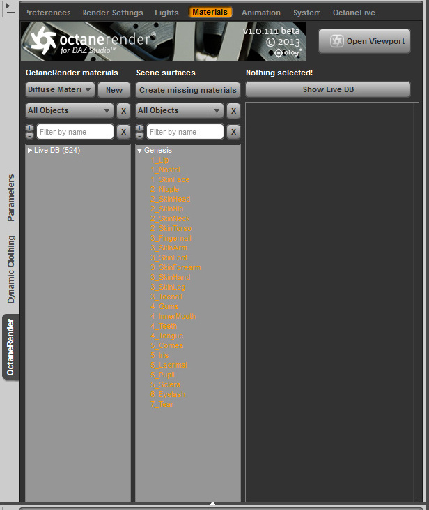

i can perfectly understand youTofusan wrote:@t_3:
I conducted the procedure as directed to you.
Materials are lined up in the right-hand side. Nothing in the left.
In my poor English, I may not be able to explain to you well. I attach a screenshot.
so, this is after reloading? then please, once more, send me exactly that .duf, as Zip attached to a pm; and bear with me, i will need some time to look into this really strange behavior...
