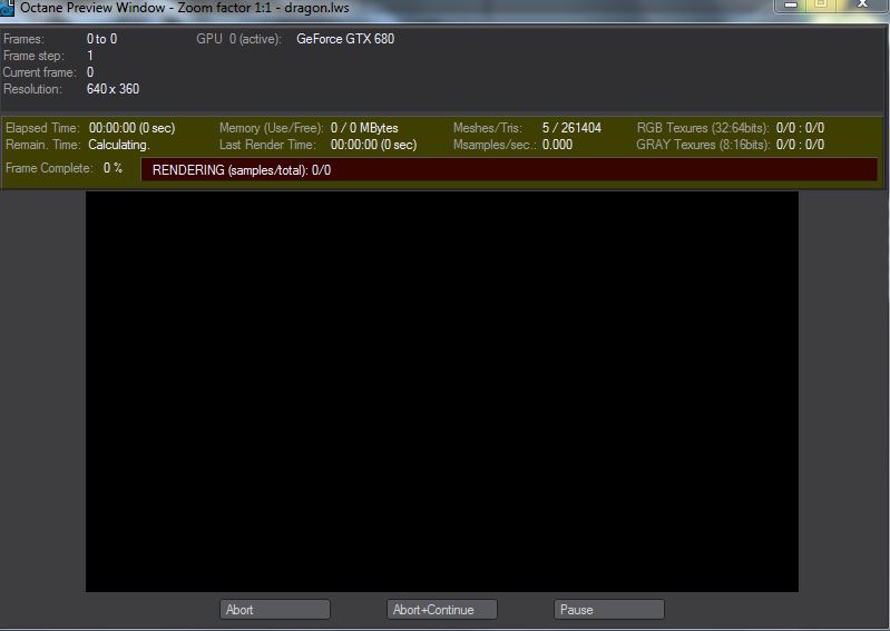

ok i have test it today in lw1.5 x 32
and when i hit f9 it stucks to that
any idea

drako3d wrote:ok i have test it today in lw1.5 x 32
any idea
And the IPR works? ... it is hard to say. If you want please write to me to [email protected] and I will try to fix your problem. With LW 11.x and GTX 6xx GPUs I have not seen this kind of problems.

Postby drako3d » Sat Mar 23, 2013 12:58 am
drako3d Sat Mar 23, 2013 12:58 am
i have reinstall the plugins and now it works in lwx 64.what can i say....i cant understand.
nevermind tomorrow i see in lwx32.im tired i go to sleep.
btw i have render a seq in animation i made and damn......fast as the wind and impressive quality.
thanks juan but i ve just started with this monster and i have to play more....
thanks....
